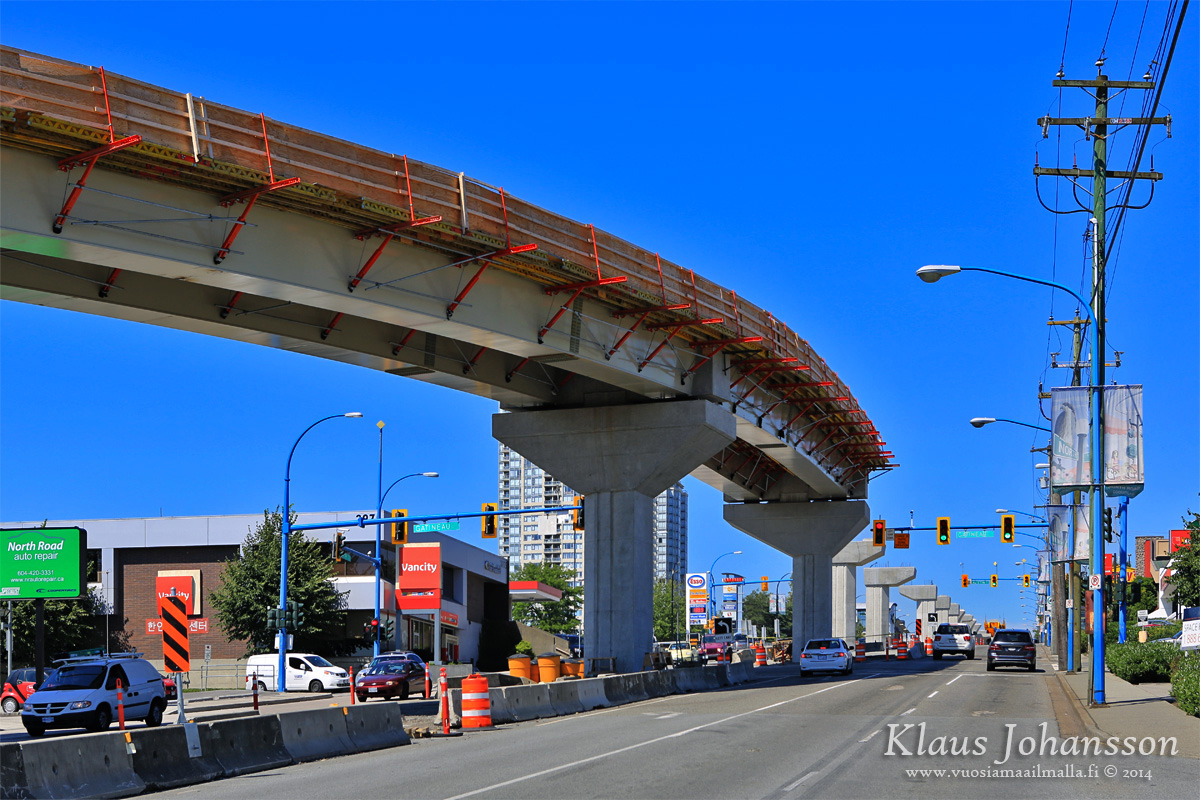

North Road looking south. Guideway construction has reached the column directly to the left of me (just out of the picture) as you will soon see:
Across from the McDonalds:

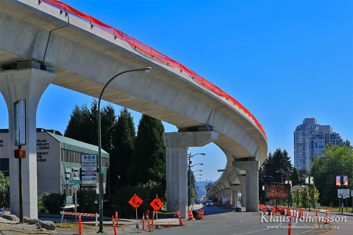

A few snaps of the infamous curve at Lougheed:
Over White Spot:
Hopefully it won't be too loud when trains start traversing the curve, or else it'd be pretty unpleasant for diners underneath.
The other side. Notice the infamous grade differential between the tracks.

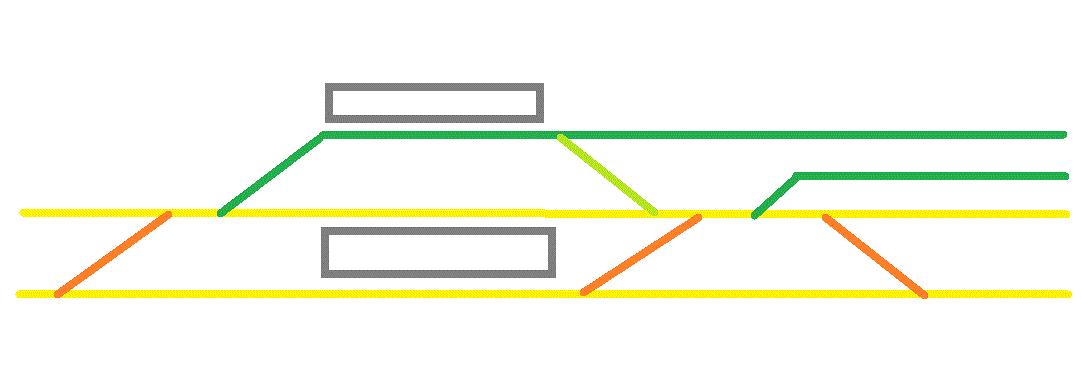

Man, I was just trying to get my head around train operations at Lougheed Town Centre Station.
As far as I can tell, there's going to be mad switching of tracks for pretty much every train going through there.
According to Wikipedia:
An additional platform will be constructed on the east side of the station, completing a roughed-in platform and track that were constructed previously in anticipation of the Evergreen Line extension. When the extension opens, this platform will be used for Douglas College Station–bound trains. The centre platform will be used for the terminus of the Millennium Line as well as VCC–Clark-bound trains, allowing for cross-platform transfers between those two services.
Which means that the Evergreen line trains (assuming they run on the right side of the tracks) will have to cross in front of each other to get to their respective platforms.
I've roughed out a rail diagram for the station:
Existing Millennium line in yellow and orange, new Evergreen lines and connections in green.
As far as I can tell, the operation described in the Wikipedia article is not possible without running the trains on the Evergreen line on the left. Anyone have any further insight into how they're going to be operating this? It looks like having the north platform be westbound, and the south platform be eastbound should work just fine. Though things get a bit weird if you need to do a turn-back: either you need to stop and reverse direction while on a main line, or you force your passengers to get off at the wrong platform to continue in the same direction.

Here's my post from the first page of the thread - this is an excerpt from the Partnerships BC RFP.
Trains to Coquitlam will "wrong-rail" for a bit until Burquitlam Station.
Although, now it appears that Millennium Line trains will through route to Production Way Station, rather than short-turning at Lougheed Station (so the blue line will follow the red line through the station to the west, and the yellow line will originate from the west and head through the station).
The new western terminus for the M-Line is Production Way because buses to Simon Fraser University depart from there and its centre platform would eliminate some up and down transfers.
BTW - the station is designed so that there is a single platform for each destination - which avoids the Toronto interlining disaster where trains were split between two platforms (at St. George and Bay Stations), but the number of switches provides for a lot of flexibility on routing.
JACKPOT!
This confirms the proposed train movements from SteelWheels' circa 1999 PMC Line brochure.
And it does look like the trains will run "wrong side" all the way to Burquitlam (red and green arrows).
You can also see that the Millennium Line terminates at Lougheed (blue and yellow arrows), with an easy cross platform transfer to Vancouver (but not from Vancouver).

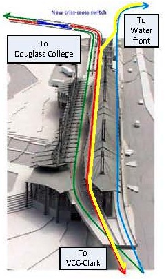

With the M-Line trains running through Lougheed Station to Production Way Station, the movements will be simplified like this:
Note that originally, in 1999, there was to be a double decker track and a basketweave on the curve (above the White Spot restaurant), but that was deleted as a cost savings measure and replaced with level switches, which forces the wrong-railing - it also created a disparity in the elevation of the 2 tracks as they round the curve since the original tail track was angled upwards in anticipation of the double decker track.
Note that the new Lougheed platform was not built to the original design, either. The new design is simpler (and no doubt, cheaper).

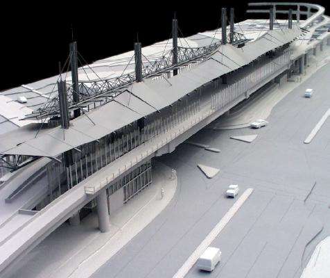

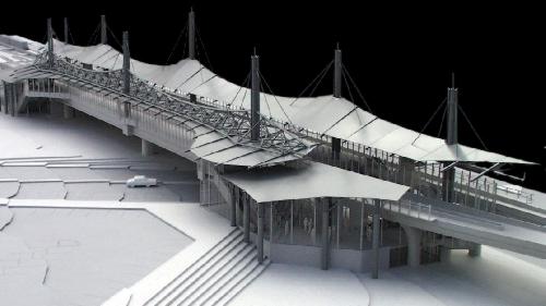

Here are pics of a model of the originally proposed configuration for the PMC Line at the Model Shop website.
It shows the turnout for the tracks heading up North Road (as well as the third platform).
http://www.modelshop.bc.ca/porty2/file/4000/4021/4021-1.htm
Model from the other direction:

The red line is confusing in the second diagram. It seems one red comes from Douglas College and the other red comes from Waterfront. The drawing should have had an additional colour and had (say) yellow go from Waterfront to VCC-Clark. (if anything, yellow and blue should be switched to match the above diagram with yellow being towards Waterfront and blue coming from Waterfront.
Is this correct?

So service does indeed go the "wrong" way for a bit, and there is extensive use of crossovers.
It's interesting though, if they're going to run the M-line to Production Way. Suddenly they lose a lot of the benefits of the switch and platform flush Lougheed. I suppose trains will proceed past Production Way, switch tracks at Underhill Ave, and then start their reverse journey. They lose a little scheduling flexibility in having that south track at Lougheed being a psuedo-pocket track.
It definitely makes the transfer nicer, for those wanting to do the equivalent of the current M-line. Just change trains from the same platform at Production Way, instead of having to climb down from the north Lougheed platform, and get to the centre platform to continue on to New West.
Is this correct?
Yes, that's correct. I did that diagram a long time ago and the red just indicated a common destination (not origin).
Yes, with the proposed frequencies, the reversing on the mainline shouldn't be an issue. In future they may have to short-turn at Lougheed.
There will still be a cross-platform transfer at Lougheed for transfers from Coquitlam to New Westminster. On BurlOak's revision, from red to blue.
For transfers from New West to Coquitlam (on BurlOak's revision, from yellow to green), it'll be an up/down transfer (or ride to Production Way for a cross-platform transfer).
A transfer between the blue and green lines can be avoided by getting on the correct train to begin with.
